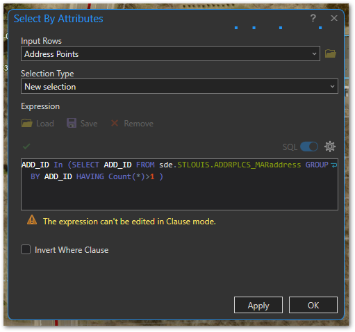

Matt-Goodman
As I dig in deeper, I'm starting to think I have a uniquely glitchy bug.
Starting with a totally clean project/map, with only one single feature class I can get the query to work normally, especially when I intentionally put duplicate ID attributes for it to select. I can run the Select By Attributes and it will select them. However, when I run or validate the query while there are not any duplicates present for it to find, it behaves abnormally:
  • When validating (clicking the green check mark) it returns a message that the query is valid, but it does not also give the usual message stating that no records were returned.
  • When executing the query, it appears to do nothing and then when closing out of the Select By Attributes dialog, the cursor turns to the "processing" wheel indefinitely (or at least for more than 30 minutes, which is debilitating).
So far the only field that seems to cause this issue is the ID field that I'm trying to check, which is a 36 character UUID (but not an Esri GlobalID and not managed by the database). I can perform the same test on, for example, the address number field, and it successfully selects the many duplicate address numbers.

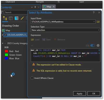

Matt-Goodman
Still don't have any idea what's going on.
I tried a fresh/clean .aprx with just one single SDE data set in it. I ran this Select By Attributes looking at an integer field, [mar_id] and the application was basically incapacitated for over an hour (I quashed it to go home for the day).
It did, after about 40 minutes, return the message stating "The SQL expression is valid, but no records were returned." But even after that message, I was stuck with limited functionality as the 'processing' cursor continued to spin. Even after closing the Select By Attributes dialog, the cursor remained and context menus were all grayed-out.
