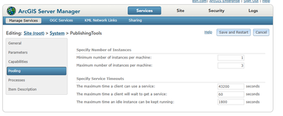

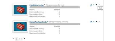

Yes, users should have the ability to change the settings of the service they have published, this part I have no problem with.
But with current design, they could also start/stop system GP, change system service parameters, like in the screenshot below, which in my opinion it's bad design and this should be admin's previlege not user's.
