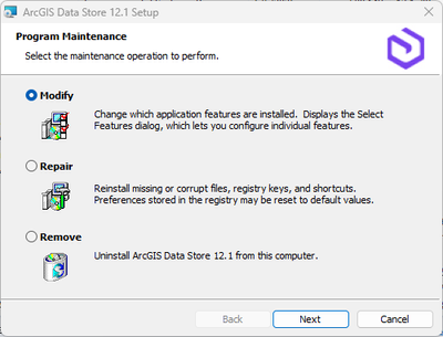

You can execute the unregisterdatastore command to unregister the tile cache.  Then you can change the application from the Control Panel by right-clicking.
You will be presented with the option to Modify the application.

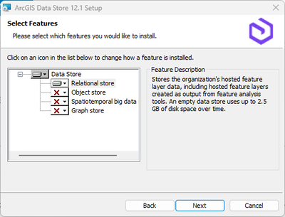

When proceeding through the wizard, uncheck the Tile Cache, but keep Relational checked.
Note, Tile Cache is missing b/c this is 12.1.
