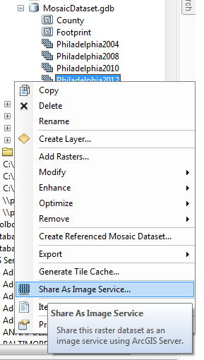

I'm trying to publish raster data as in image service. I've found a link with instructions on how to do this here. I'm able to get through step 3 just fine and verify my folder data source, but when it says to navigate and right-click the dataset, I have no idea where the dataset is supposed to be showing up.  Registering a data store doesn't seem to affect what shows up inside of ArcCatalog, so I don't know where I'm supposed to navigate to the dataset from.
Any help would be appreciated!

Hi Robert,
For step 4, you just need to right-click on your raster dataset/mosaic dataset.  Ex:

RobertYarbrough
Thanks Jake!  I was trying to map the .gdb folder inside of ArcCatalog instead of the folder above it and ArcCatalog was having none of it.  After seeing your post, I shared the parent folder and now things are working smoothly.
