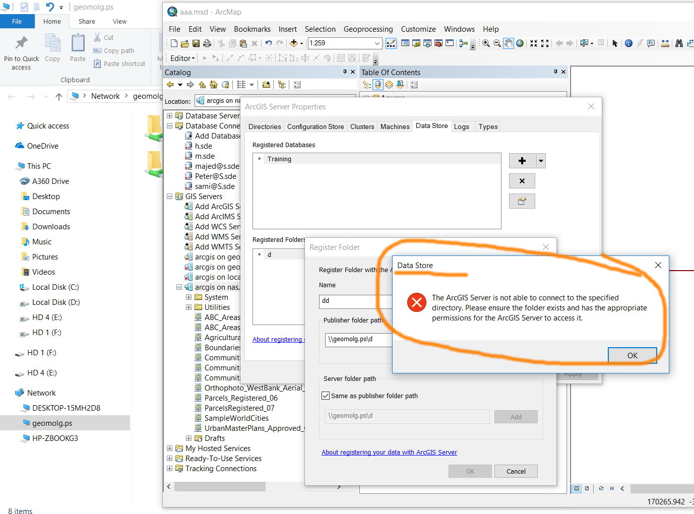

We are having the same issue in ArcGIS 10.5
Jamal Numan
