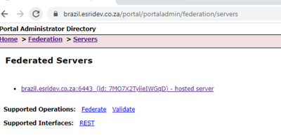

HenryLindemann
Hi @MohammedElsayed
can you log onto the server ?
if yes go to the equivalent url https://yourdns.com/webadaptorname/portaladmin/federation/servers
click on the name  and then validate and have a look at the error there
ArcGIS datastore needs to be registered with https://yourdns.com:2443/arcgis/datastore on your server.
you can also in a administrative command prompt check if datastore has a problem by running this command
"C:\Program Files\ArcGIS\DataStore\tools\describedatastore.bat"
Hope it helps
Henry

HenryLindemann
Hi @MohammedElsayed,
let me get some history is everything installed on one server or multiple servers ?
on the server you can try https://localhost:7443/arcgis/portaladmin/federation/servers if this is the server that portal is installed on.
or perhaps https://onesourcemei.fugro.com:7443/arcgis/portaladmin/federation/servers
or https://onesourcemei.fugro.com/arcgis/portaladmin/federation/servers
or https://onesourcemei.fugro.com/portal/portaladmin/federation/servers
have a look at your programs and features the web adaptors will be listed there
If you go to add remove programs is ArcGIS Data Store installed ?
