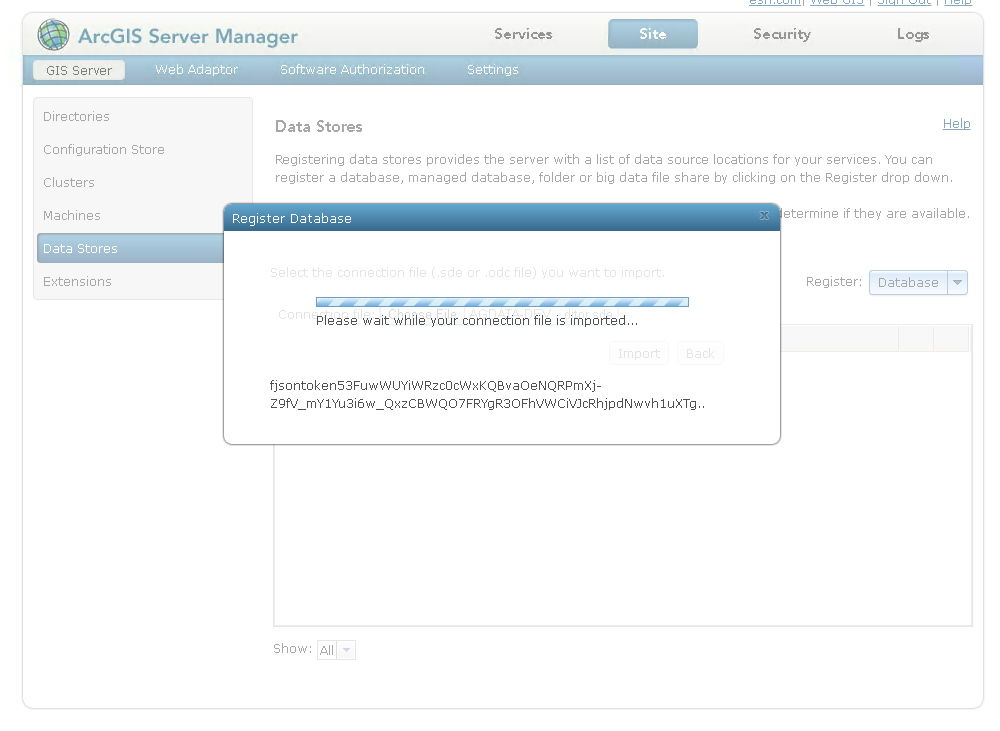

I'm traying to register a database to ArcGIS server 10.5 but i couldn't complete the operaration
I create a geodatabase (Microsoft SQL Server Standard Edition (64-bit)) with arcmap 10.3. Using the sde file aim I try to import to Arcgis but nothing happens.
Screen shot
It stays like the image for hours. Somebody can help me?
Thanks.
Mauricio

Thank you Rebecca. I was using Google Chrome, with Microsoft Edge I could complete the task.
