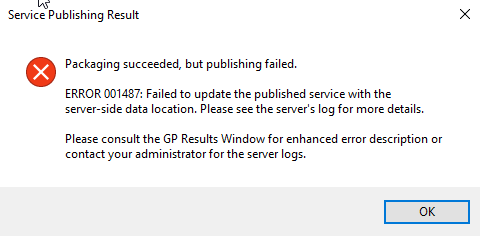

I am publishing a network analysis service as instructed here.
Tutorial: Publish a network analysis service—Documentation | ArcGIS Enterprise
Upon publishing, I get this error.
The server log shows this error.
I have tried many ways to publish the service. Registered database, registered folder, not registered folder. The final changes the error to 001369, with the following error logged on the server.
Any ideas would be greatly appreciated.
Thanks,
Geoff
BrianVan_Nostrand
Thanks for the reply. I'll say both to you and for future viewers of this thread, the issue we were having was a version clash between our server (10.3.1) and desktop (10.6) versions. I resolved it by installing desktop 10.3.1 on the server machine with the old server version and published from there. This is also not an issue that can be resolved by saving a copy down from the current desktop version. ESRI has not really documented this issue and couldn't solve it on my support call. This thread is the end of the line
Fouad_Geoffrey
Very helpful. Thank you, Brian. Original issue occurred now over a year ago, but I seem to recall difference in versions between server and desktop. I will note this for the future, and mark your answer as correct since you've likely identified the source of the error.
