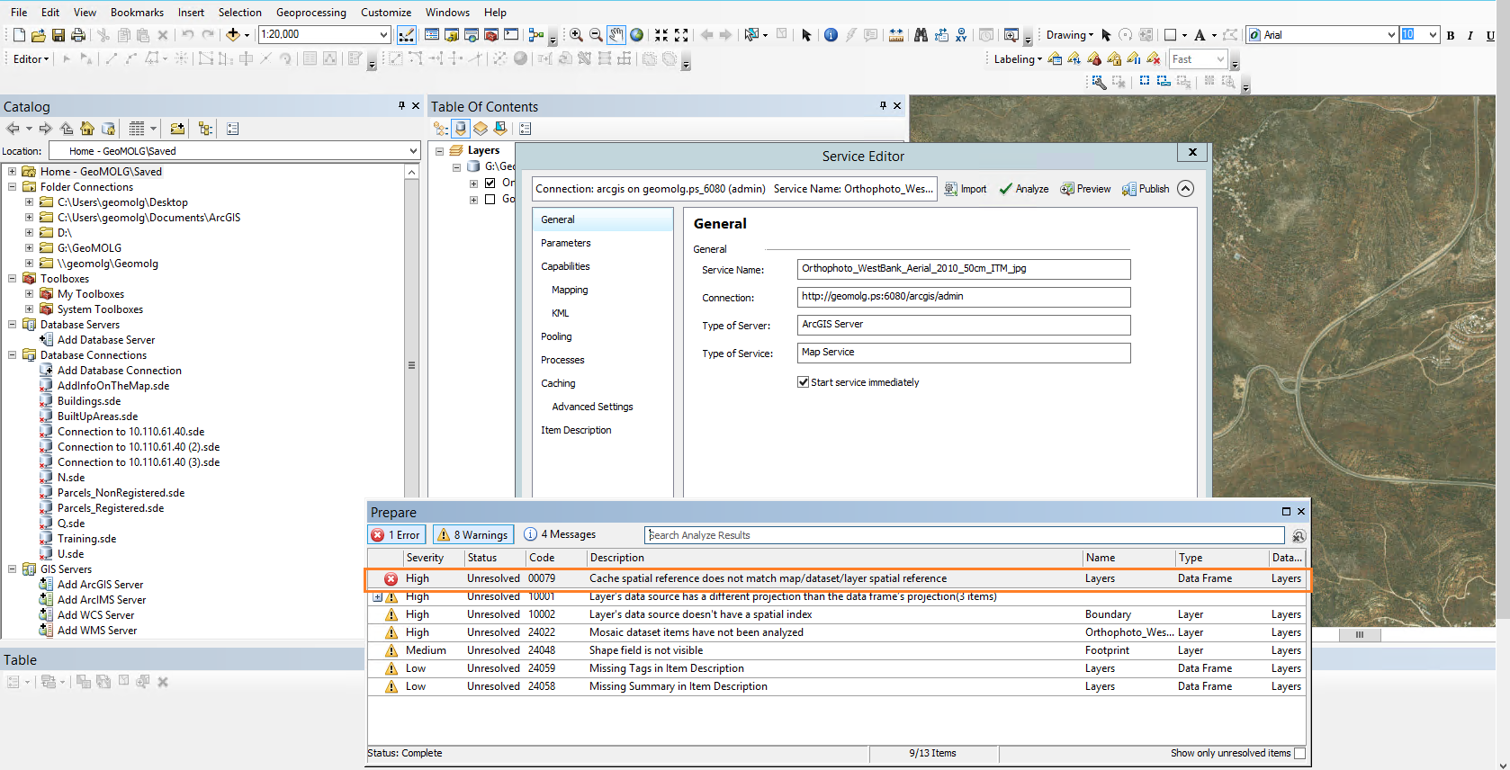

After the cashing of the orthophoto is finished and when I try to publish the cashed orthophoto I found the attached error
What might be the issue here?

I would recommend reviewing this help link: 00079: Cache spatial reference does not match map/dataset/layer spatial reference—Documentation | Ar...
Your data frame/dataset/layer's spatial reference must match the spatial reference of your tiling scheme in order for tiles to be created.
You may need to make sure all the spatial references in the map are the same.
