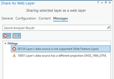

I'm trying to publish an editable Web Feature Layer where the users should be able to edit and update some fields. I have this feature class in a FGDB, and whenever I tried to publish the layer to the portal, I got the below error:
and there is no option to correct this error. Any thoughts?
berniejconnors
FGDB does not support editing on a featrue service.  You need to use an Enterprise geodatabase.  Here is a similar question - https://community.esri.com/t5/arcgis-online-questions/layer-s-data-source-not-supported-feature-serv...
