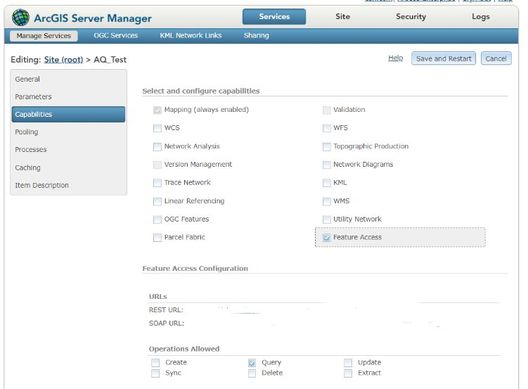

have you tried going into the server manager where the map image service is published, enabling feature access to spin up a feature layer, and using layer to get around this issue? we were playing around with this and were wondering if there were gremlins we should be aware of...
MichaelVolz
The service publishing process will throw an error {Layer's data source is not supported (Feature Services)} when you try to enable feature access for a file geodatabase.  Until ESRI makes this possible, it seems like Feature Access should be disabled on that screen if a file geodatabase is the data source.

MichaelVolz
Bernie:
I tried to just have Query on Feature Access with a file gdb data source and that is the error that I reported earlier.
