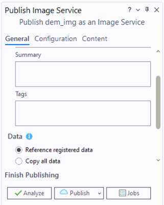

Just wanted to verify one more thing. Unlike map service, the item data source is set to the directories folder ("C:\arcgisserver\directories\arcgissystem\arcgisinput\...") and not to the folder that my raster is originally in ( that is set as data store). Can I change it to the original location or it is default for image server?
TonyContreras_Frisco_TX
You should be able to select the option under "Data" to reference registered data. Make sure that the path is registered with the site and if you have multiple machines in the site that the same path is valid for all. Either a UNC path or  if local drive, the data is on the same location for each server. Also the service account running arcgis server must have access to the path.
