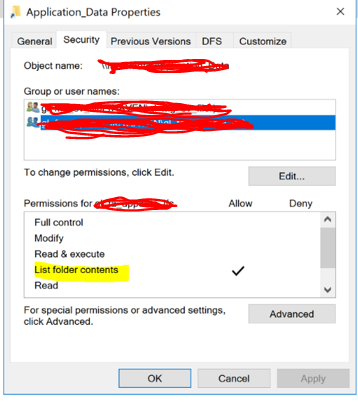

Yes, I was able to solve it. It appears that it's not enough that \\ourfileshare\Application_Data\gis\ArcGIS_Portal\Test\arcgisportal\content was accessible to the Windows account that runs Portal for ArcGIS. The same account should also be able to drill down through all levels in the UNC path. This can be achieved trough the permission 'List folder contents'. See attached screenhotCapture.PNG
I hope this solves your issue

PhilippeVDV
Best regards
Phil
dgiersz_cuyahoga
Thank you @PhilippeVDV !  This solved my issue as well. You should mark your reply to me as the Solution to help the next frustrated Portal admin. 🙂
