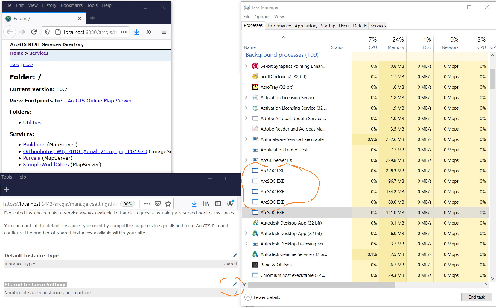

Jamal,
    Instances indicate how many processes are ready to handle incoming requests.  Each instance has a corresponding ArcSOC.exe process.  There are ArcSOC.exe processes that are not related to instances, but the vast majority of ArcSOC.exe processes are for instances handling incoming requests.
You can identify which ArcSOC is associated with which service using Task Manager.  Here's how.  In Task Manager, use the "Details" tab, you add columns by right-clicking on any of the current columns (such as "Name" or "PID") and choose "Select Column".  Put a checkmark next to the "Command line" column.  The command line column will be too short to start with, so you can make it larger and you will see the service name listed in the column.
