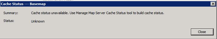

I have been successfully caching my basemap this morning, however I can't produce a cache status using the "View Cache Status..." context menu item.  I have run the tool "Manage Map Server Cache Status" several times, which takes some time to run (13 minutes last time I ran it) however I still can't see a cache status.
I get this message:
Any ideas on how I get get the cache status?  I would like to confirm that my cache is being fully generated now (after the issues I was having with 10.1)

well the cache process errored out (when I ran out of disk space!) and finally produced a cache status   No idea why one wouldn't produce before that, but it's there now.  Not a solution, but I have what I was after.  Now to arrange more storage.

Glad you fixed your issue. For those that may stumble across this thread: When my status.gdb has gotten corrupt, I've had luck deleting the Status.gdb for the service and then running the cache status tool (It''l generate a new one which should work/ be accurate).
