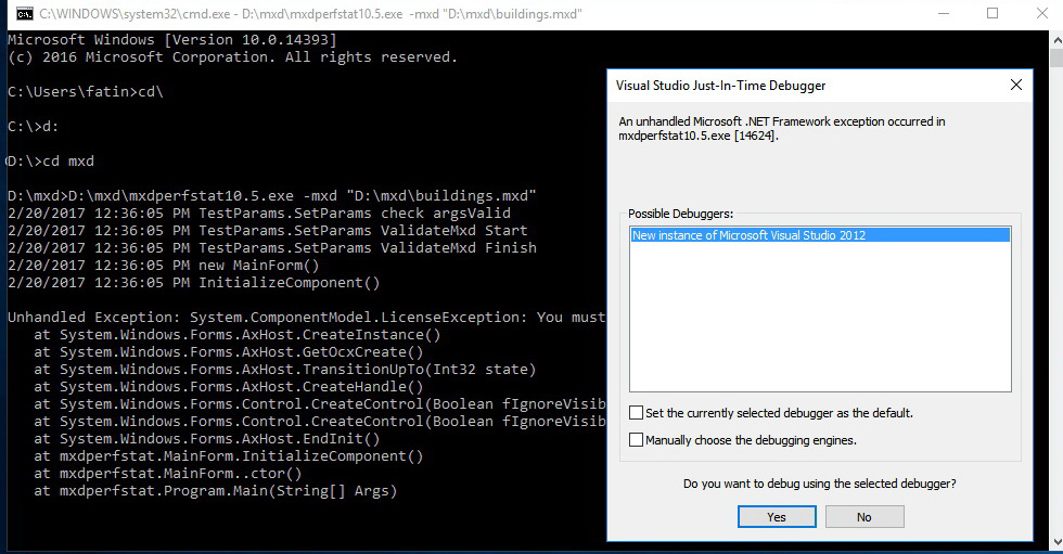

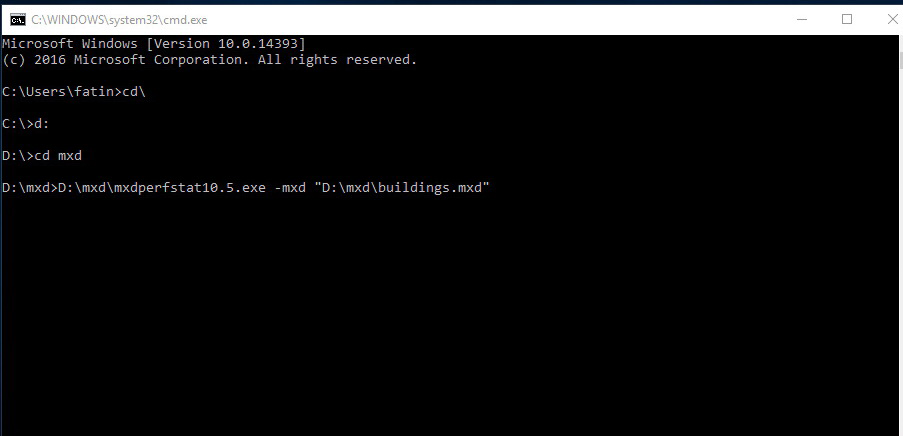

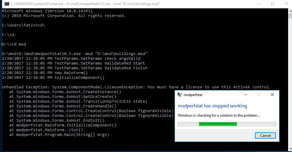

I had an error when i tried to run the mxdperfstat report.
Please see the following screenshots.
N.B: I am using 10.5
what might be the issue here?
Thank you,
Fatin
RandallWilliams
Sounds like MXDPERFSTAT is looking for a license. Are you running this on a machine with either:
a. ArcGIS Engine runtime or
b. ArcGIS Desktop
FatinRimawi
Hi Randall,
Thanks for replaying.I am using ArcGIS desktop.
I followed the instructions to run the mxdperfstat report before on ArcMAP 10.4.1, it worked fine with me, but for 10.5 i had this error.
