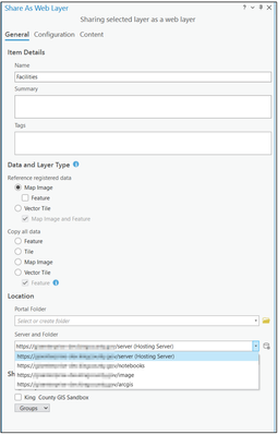

Once you have a multi-machine deployment, you will see an option for which server to use during the publishing process from Pro.   If you are creating a hosted feature layer, it will automatically go to the hosting server and be stored in the data store.   If you choose to publish a service referencing data in an EGDB, you will get a drop down list of all your servers.
The unfortunate part of this is that it will default to the hosting server, so if you are allowing users to publish their own services, you can't really control which server they publish to -- you can only educate them which ones to use.
