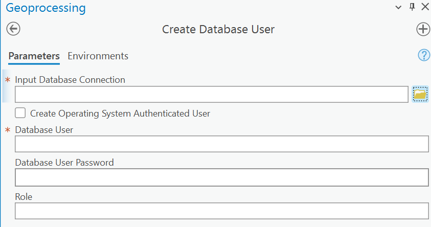

Hello,
I've create a few users to our MS SQL successfully.  On my last user creation, I botched the password and the doesn't have access as a result.   What is the best workflow to:
1) change password of user (without knowing current password) OR
2) delete user and re-create.
Thank you,
Tyler
Enterprise 11.2
p.s. This is the geoprocessing tool I'm using to create user, called Create Database User.
I'm not readily seeing a change password geoprocessing tool.
ChrisUnderwood
Hello @TylerT , an Admin user can change another user's SQL Server Authenticated password directly in SQL Server Management Studio > Login Properties. But of course, this change will not propagate to other places you may have stored it such as an Esri Database Connection file.
