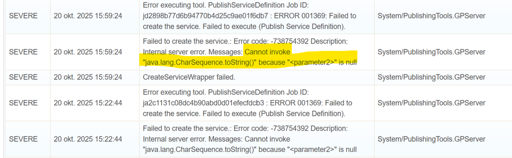

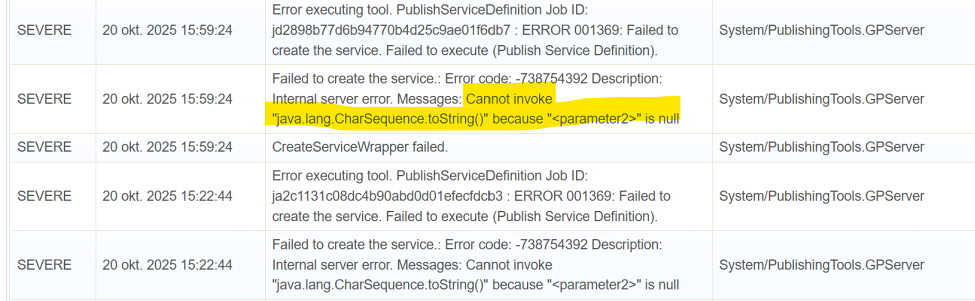

But when I want to publish a service (and test the PublishingTools GP service) :

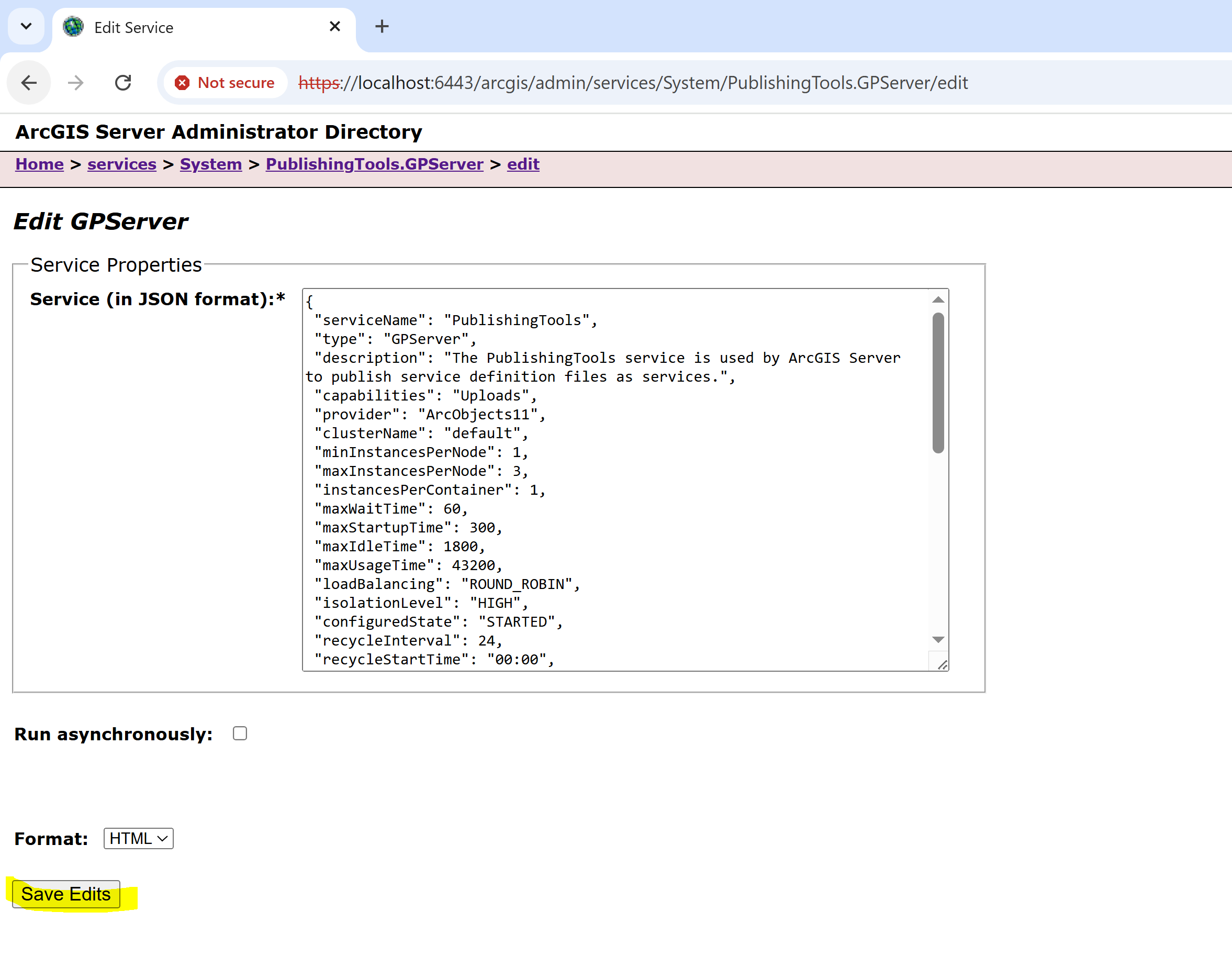

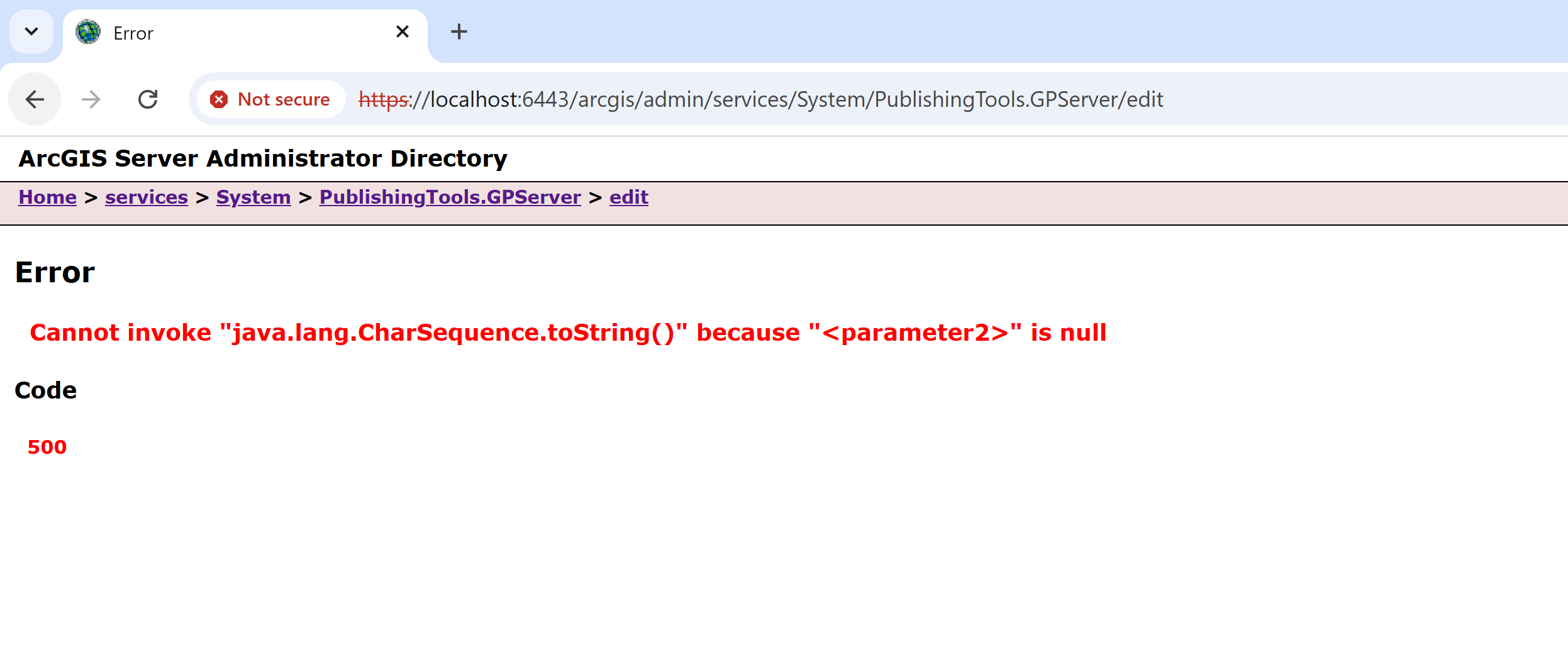

While further troubleshooting, I notice the same error when I try to edit the json config of the service (whitout changing anything)
Cannot invoke "java.lang.CharSequence.toString()" because "<parameter2>" is null
I see this error for ALL System service that I try to edit.

I did the same test on a locally installed 11.5 ArcGIS Server on my laptop: deleted the System folders; next copied the same folders from another 11.5 deployment on Azure and the System Services work! This proofs that I'm copying the right folders I believe. But when copying to a fileshare, although everything looks OK, there's this error:

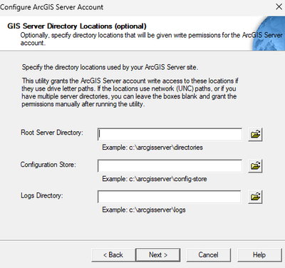

A bit far fetched but have you tried resetting the permissions using the "Configure ArcGIS Server Account" wizard ?
I did helped for me with issues with the System services.
