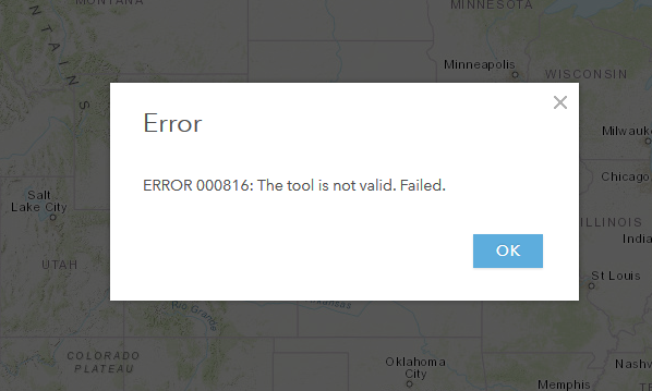

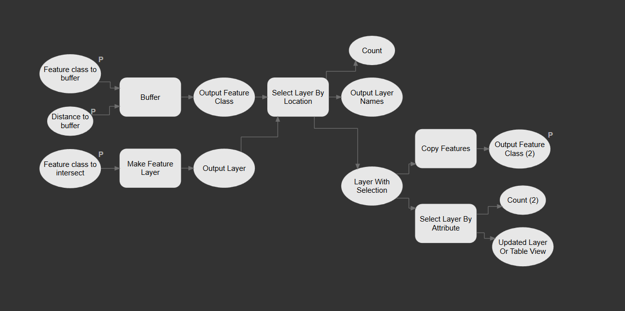

I'm starting to learn how to publish web tools from Pro to our portal and have made a simple ModelBuilder tool.
Tool works just like it should in Pro. However, after I publish it to our portal it always fails and I get the following error;
Not very descriptive and after searching for about half a day on Google it seems no one has the answer to this.
I'm running Pro 2.3.3 publishing to Portal for ArcGIS 10.6.1
ShingLin
This is a bug for the tool SelectLayerByLocation published as a web tool from ArcGIS Pro 2.3 to Enterprise 10.6.1. You have two workarounds:
1. For SelectLayerByLocation, don't use the tool directly, make a script tool with the following code (You have to include copyfeatures):
      import arcpy
      import os
      layer1= arcpy.GetParameterAsText(0)
      layer2= arcpy.GetParameterAsText(1)
      outfc= arcpy.GetParameterAsText(2)
      arcpy.management.SelectLayerByLocation(layer1, "INTERSECT", layer2, "", "NEW_SELECTION")
      arcpy.CopyFeatures_management(layer1, outfc)
2. Update ArcGIS Pro and Enterprise to 2.4 and 10.7 respectively, then run your model.
