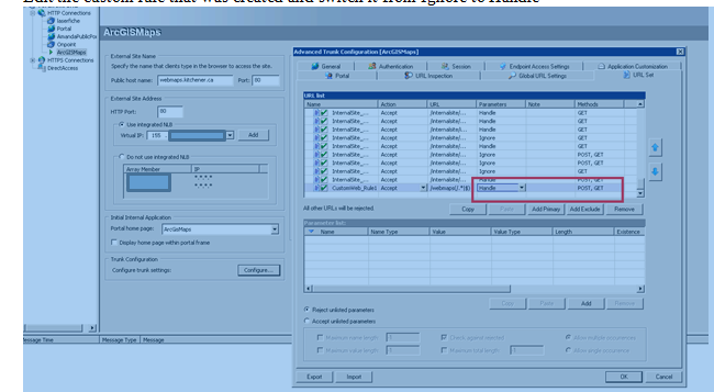

We have Microsoft's Forefront Unified Access Gateway (UAG) and Webadaptor set up but we can't figure out how to get UAG to let the rest services through. Does anyone have it up and running together and if so how did you do it?
MelanieWawryk
This link shows how to do it, How to Configure UAG to Publish Your Private Certificate Revocation List - The Cloud Security Man - ...follow the steps to use UAG as a simple reverse proxy to your webadaptor link. Just replace references to CRL to your webadaptor name. For example in step two
put the trunk name in as something like ArcGISMaps and the public host name as the name you used in webadaptor for example webmaps.yourdomain.com
In step 5 add the address as the fully qualified server name that you have webadaptor installed on and put the path in as the name you used in webadaptor (default is /arcgis)
Follow the sets in the link and at the end Select Trunk Configuration and choose Configure. Edit the custom rule under URL set that was created and switch it from Ignore to Handle
Select ok, save and activate UAG. This worked for us.

MelanieWawryk
MelanieWawryk
Sorry just noticed I typed the last instruction incorrectly: It should read:
Edit the custom rule that was created and switch it from Handle to Ignore. This will ignore any parameter rules.
