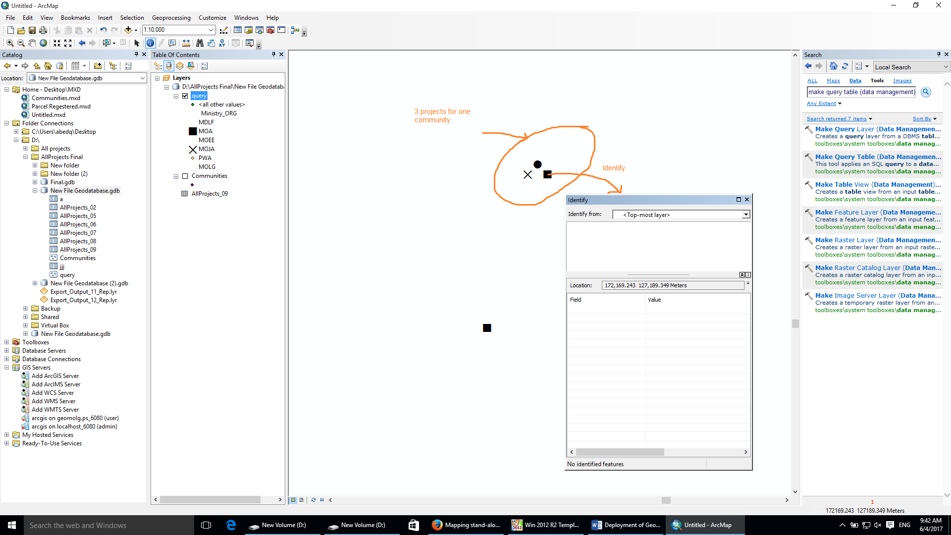

In the screenshots below, some of features of the layer corresponds to multiple records in the stand-alone table. Then, how these RECORDS can be displayed in the map to get what appears in the second screenshot?

when I was use make query table then i selected my symbols, I found that we can’t identify each symbol. please see the attachment
Is there a way to make each symbol to be identified?

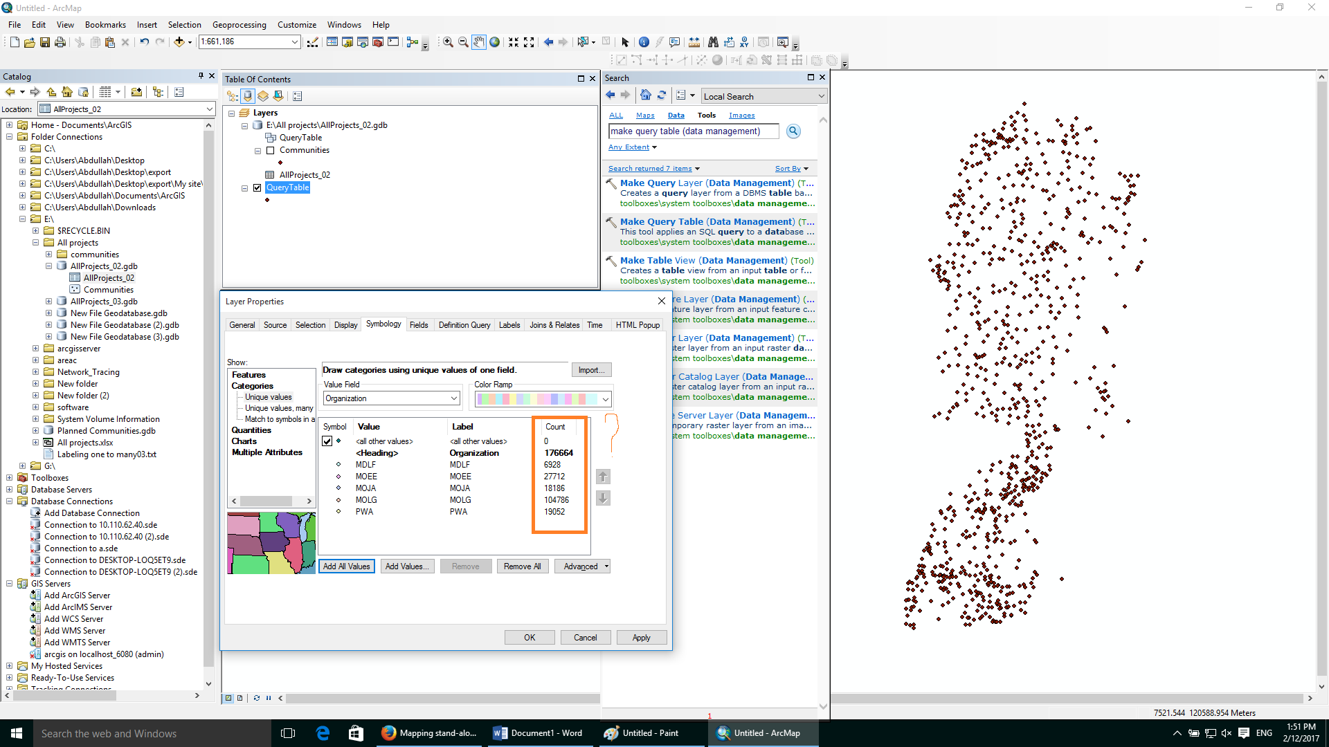

I used Make query table tool and I am facing the following barriers

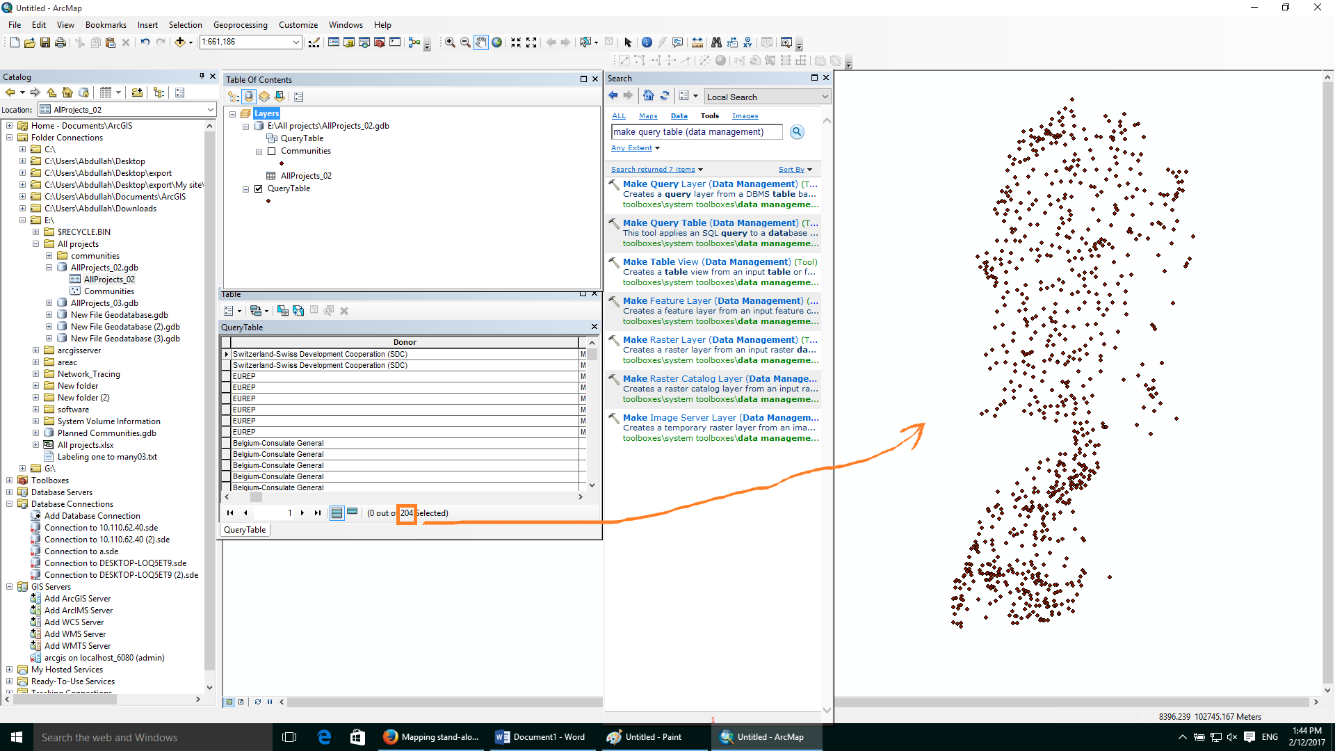

.1-community layer contains 866 points and Query table contain 204 points, I noticed that the map contain the same number of points in both of them?
2-
  • Number of organizations that appear in symbology is more than 175,000 despite the fact query table contain just 204 points

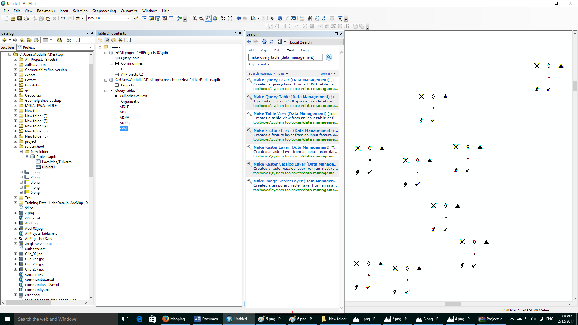

  • I have 5 different types of symbols, when I applied the symbology all the types of symbols appeared for each point despite the fact  not all points contain all symbols
