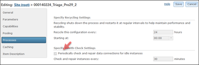

I assume you have this help check option checked, right?
anyway, I think it is probably better to open a ticket and have an analyst take a look at this.
KeithOlsen
It is checked, but I hadn't seen that option before. I changed the recycle rate to every 6 hours, but still, it shouldn't be dropping the data connections that often. It's also weird that it's only happening with the arcPro created services (I have an older arcPro service that seems fine). Maybe a bug in the recent arcPro release?
