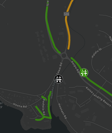

Hello,
We recently made an update to the pop-up for a Roads feature service and republished it to the server. The Feature Layer works correctly, but it is Map Image Layer now seems to have been experiencing a projection issue. This only on the public-facing map only not in Pro where the road lines  are no longer properly projecting on-the-fly. However, the pop-ups themselves are projecting properly. (Screenshot examples below)
Has anyone been experiencing similar issues?
On Enterprise 10.8.1 on a two server setup with Portal on one server and Datastore and ArcGIS Sever on the other. Pro 3.0.1.  All layers are WGS-84 Web Auxiliary sphere
Road misalignment shown
Popup showing correct location

Hey Garrett,
Check out BUG-000134770 . I ran into it lately with data I thought was all in the same spatial reference. It sounds like all your data is in one spatial reference, but always a good idea to double check. Good luck!

GarrettJohnson
Thank you!  That worked!
