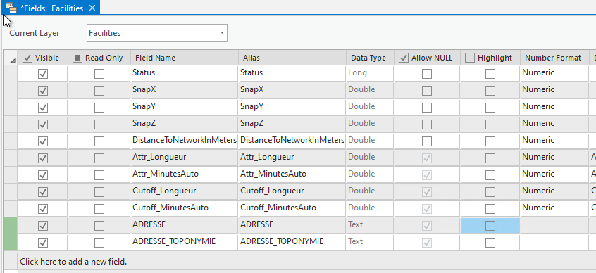

I am using Pro 2.9.14 to create an aprx that contains a Network Dataset and a ClosestFacilities Analysis layer.
I used the Add Field To Analysis Layer (Network Analyst)  to add some fields to the <<Facilities>> sublayer of the analysis layer, namely the ADRESSE and ADRESSE_TOPONYMIE fields.

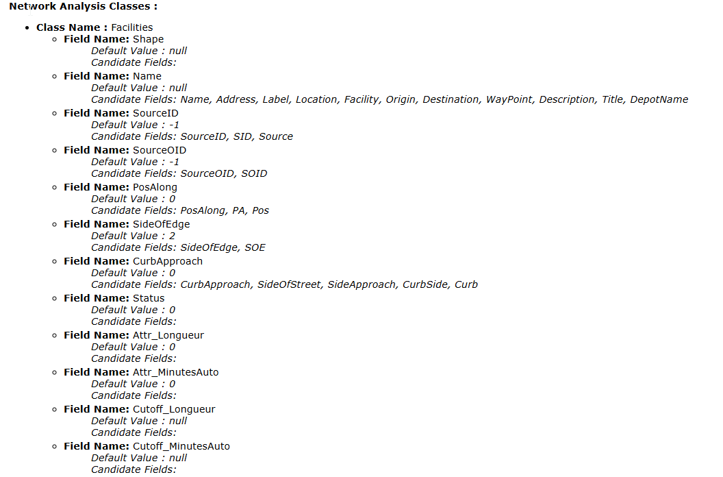

However, when I publish to Arcgis Enterprise 10.9.1 (which have the NA extension), those new fields are not included in the NAServer and are not available in the <<Facilities>> layer. Only the default fields are published.
Is there a way to publish the NAServer with those fields? I wonder if this is a bug, a new limitation or if there is an option to make this working.
