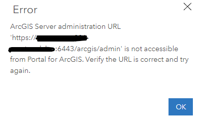

Hi All, I am trying to federate GIS servers to Portal (10.8.1) and getting this error. We have GIS server and web adaptor both installed on the same machine. The GIS Server web adaptor has valid SSL cert and I can navigate to the URL. What else could be causing this issue?
Appreciate any feedback.
Thanks

If possible, would you be able to attempt to disable the firewall temporarily to check if it is a firewall issue? You may need to do this on both machines
Here is a diagram of all the firewall rules, I would ensure that all of these are open on the respective machines:
https://enterprise.arcgis.com/en/system-requirements/latest/windows/pdf/ports-enterprise-deploy-dgm....
Hope that helps!

This was an issue with SSL for ArcGIS Server that was expired, admin end point was blocked due to this. Once certificate was updated, I was able to federate successfully.
