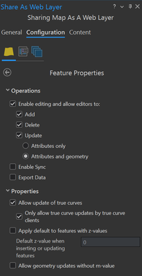

When you publish a feature service you should have the ability to control whether the feature allows new features to be added or deleted or updated from the configuration tab (screenshot below is Pro 3.1.1). Maybe you're using a new version?
By choosing "attributes only" you can prevent the feature from being moved while still allowing fields to be edited.

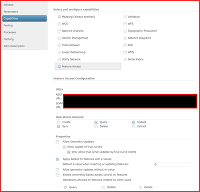

There are also some edit settings that can be updated on the server manager side. This might be where you can remove the option(s) for the Feature Access to create or delete while also keeping the option to update without allow geometry updates (i.e. the features can't be moved, only attribute information can be updated):

DanielWebb
Just want to clarify your solution. You're thought is that instead of editing the layer directly in the SQL database, I would create an editable service that looks at the layer in the SQL database and edit through that.
Eugene_Adkins
Yes, should've clarified that from the start. Apologies. I thought of it partly through the thought process (with the "in the field" comment) but failed to return to the beginning of the comment to clarify. It's an idea if you have the ability. It's a workflow we have implemented.
DanielWebb
Thanks! Looking at your screenshots and comments, this might actually be what we need. I'll talk to my boss about it and maybe give it a go.
Eugene_Adkins
I think once you get it going it will be the easiest/cleanest solution to limit access from certain accessibilities but still giving the person the ability to do the necessary data updates with worrying about the aprx being used or worrying about any "customization" on the raw data.
