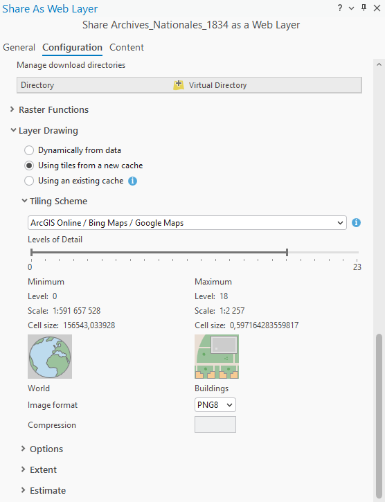

I am working with a Mosaic Dataset that I published on ArcGIS Enterprise as an Imagery Layer.
Here are the settings I used during publication:
Once published, I noticed several unusual things:
- The Imagery Layer appears very pixelated when zoomed out (see imagery_layer_pixel.png); the pixels only disappear when zooming in very closely
- It is not possible to modify the stretch or gamma values from Map Viewer
How can I improve the visual quality of the Imagery Layer and avoid these visible pixels?

I still don’t know why the WMTS causes this poor quality.
That said, I found a workaround: using WMS instead. In any case, it meets my initial need!
