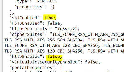

@FelipeAlbuquerque  When you mention "migration from http to https", do you mean that you imported SSL certificate and enabled HTTPS only on ArcGIS Server site?
If it fails to load after enabling HTTPS Only, you can probably try setting it back to HTTP and reviewing your workflow again. There should be a security-config.json file under \arcgisserver\config-store\security where you should be able to change ArcGIS Server site back to HTTP (as 10.1 is an old version, the file might look different - below screenshot is from my ArcGIS Server 10.8.1 federated with Portal, however look for something like "sslEnabled" and "htpEnabled" parameters):
- Stop ArcGIS server service in Windows services
- Open securty-config.json file in text editor and update to enable HTTP and disable HTTPS (Make sure to take a back up of the file prior to editing). Save the file and start ArcGIS Server service.
Hope this helps.
Irina.

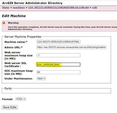

@FelipeAlbuquerque There is another file you can have a look server.xml - in my 10.8.1 its under C: \Program Files\ ArcGIS\ Server\ framework\ runtime\ tomcat\ conf - yours might be slightly different. Enabling HTTPS on ArcGIS Server adds following entry:
In addition to enabling HTTP in "security-config", maybe you can try to comment out this entry and start ArcGIS Server. Make sure to take a backup of both files. Unfortunately, version 10.1 is a retired software that is no longer supported by Esri Technical Support. Hope updating "server.xml" helps.
If you regain access to ArcGIS Server via HTTP, please make sure that:
  • SSL certificate is imported first prior to changing ArcGIS Server to HTTPS. SSL certificate should be in ".pfx" format with the password applied on it and imported via Import Existing Server Certificate option in ArcGIS Server Admin.
  • Next is to make sure to set ArcGIS Server to use the certificate by updating Web Server SSL certificate parameter to your certificate alias:
Once these steps are done, your ArcGIS Server is ready to be updated to use HTTPS.
Hope this helps.
Irina.
