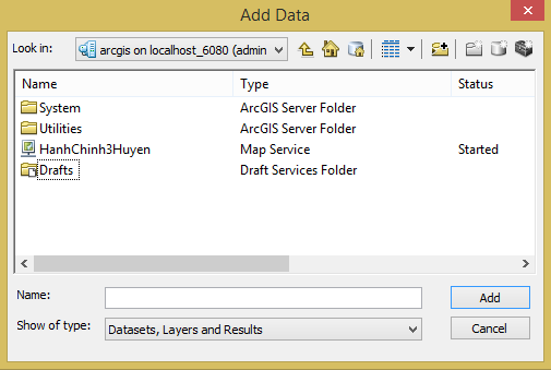

Another computer on LAN can see *.mxd file (Map service), but it can't see *.gdb file (Geodata service), you can see picture below

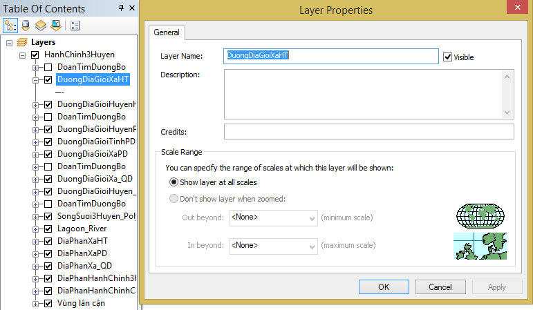

When i open 'HanhChinh3Huyen' in arcMap, it can be projected but can not query or edit data. I can only choose 'HanhChinh3Huyen' instead of choose 1 Feature class.

1. Why another computer on LAN can't see Geodata service, but map service can.

The geodata service is not meant to be viewed. And you cannot query a service in ArcMap.
You can access the geodata service from ArcGIS Server Manager and the REST url. You can also query in REST. The geodata service can be used for synchronizing replicas or working with a geodatabase in a web application or web service.
Try Webapp builder (ArcGIS Online or Portal for ArcGIS) for creating and configuring a web application. In case you want to edit spatial features, you could publish a map document with feature access.
