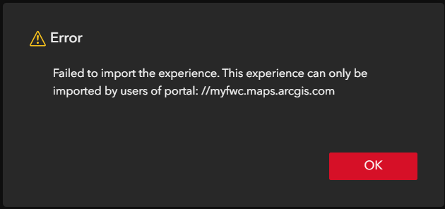

My agency is in the process of changing our servers to ArcGIS Enterprise and I have a lot of web applications that were created with Experience Builder Developer registered in ArcGIS Online that use ArcGIS Online web maps as the source data. Many of these applications have been published to our new Azure Enterprise server without issue and I have been able to start migrating our ArcGIS Online web maps to ArcGIS Portal using a Python script. The challenge I am faced with is how do to change the current ArcGIS Online web maps these applications use as their data source, to identical web maps copied to our Enterprise Portal? I already registered EB Developer to our Portal, but when I log in to the portal version and try to import one of our existing EB applications (sourced using the ArcGIS Online web map), I get this error:
I am interpreting this to mean that I must be logged in to EB registered at ArcGIS Online since that is the version used to create the application, however I don't have access to any of the content copied to our portal from the ArcGIS Online version of EB Developer.  Is there another way to switch out the web maps, or am I forced to rebuild every application using the Portal registered version of EB developer? Still learning Enterprise, so any suggestions would help.
