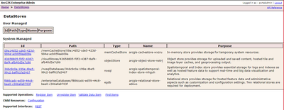

Hi Jonathan,
It is also present in the admin API. Please find attached the screenshot referencing the same.
