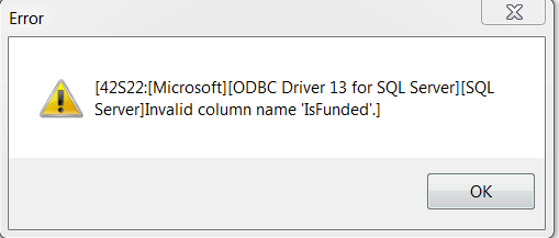

Here is the error I'm getting
I don't understand why it is seeing that column as invalid. the column is supposed to be a Yes or No (0 and 1) though the field datatype for this column is 'Short integer', Could this be a problem?

Try creating a cross database view, using a Linked Server Connection, from the Database end and then add it in ArcMap...see if that works
