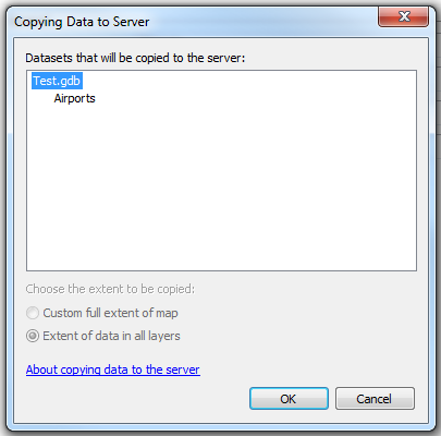

* How do I tell if the server is using data from a database, or data that has been copied local to the server?
When you analyze your data it will tell you that the data will be copied, and you will also see a pop-up:
