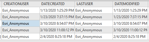

I have an app which uses the iOS Runtime SDK v100.6 which loads feature services from an on-premise installation of Portal for ArcGIS v10.7.1. The feature layers were loaded onto the map directly from their urls without requiring the user to authenticate with the portal. When the user creates a new feature and applies the edits, I can view the new feature in ArcGIS Pro, but the CREATIONUSER and LASTUSER fields both have the value "Esri_Anonymous".
attribute table for feature class showing "esri_anonymous" where username should go.
 I recognized that it is necessary to log the user into the portal before making edits, so I modified the initialization to do so (Slight variation from Esri documentation😞

Turns out it is necessary to secure any services where editor tracking is enabled. There is no way to keep it available to everyone and for new features to populate the createdby/modifiedby fields. After re-publishing the service, but only making it available to authenticated users, the user id was recorded in these fields.
