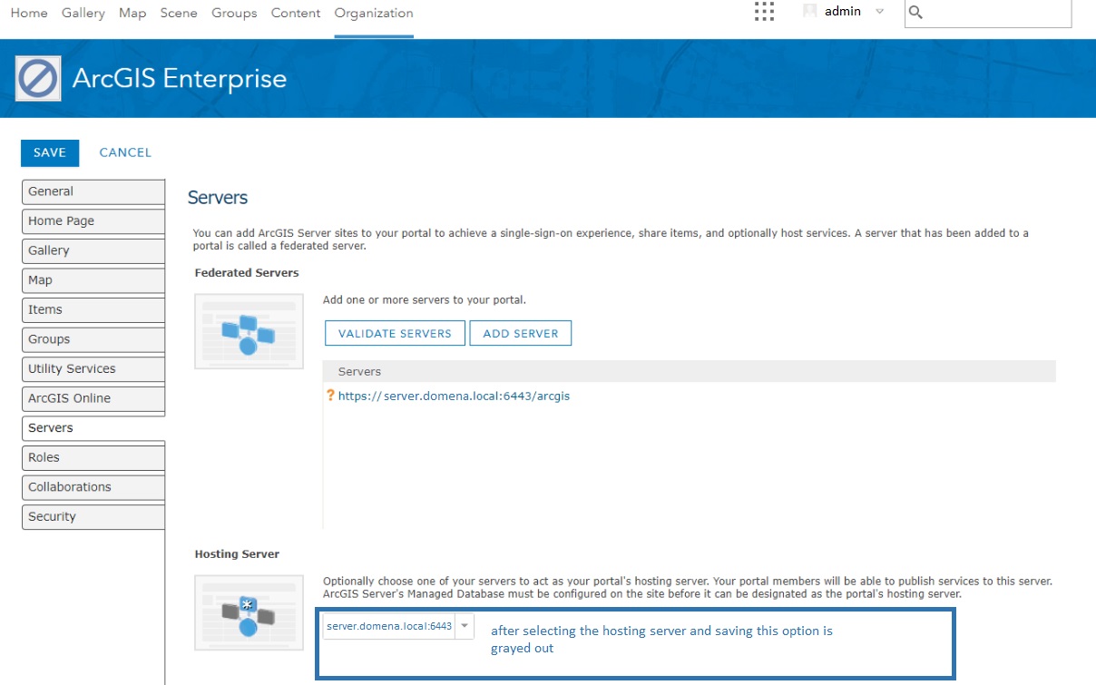

Hi everyone,
I have a question about hosting server option in Portal for ArcGis.
When I select hosting server and then save the configuration, that option change to grey out and unable to select "No hosting server"
Did anyone ever had this issue?

It looks like that evrething is ok but still I can't change options "Hosting server" .
Now the only way to change to "No hosting server" is by Portal Administration Directory
