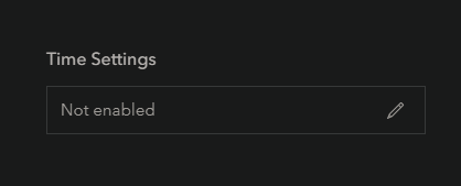

MichaelKnudson
On the portal item, going to the layer that is affected.
If you adjust the "Time Enabled" setting at all, it will fix this issue.
For some services, we turned it on, and then back off. After that it was working as expected.
