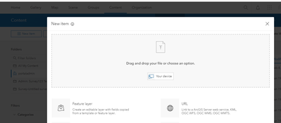

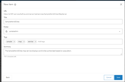

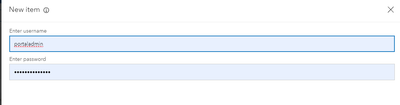

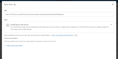

Hi @AravinthkumarBalasubramanian , yes under new item select web, you should see this page,
then select store credentials this is so that your client does not log in every time he opens the service, you log in with a user account on your system that has access to the service.
then just save
