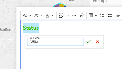

Complex popups are easier to split between HTML, Text elements and expressions. So you have 3 levels of configuration. My example is a bit simpler with only 2 values, but the idea is similar.
I have a field named {StatusText}
In the Text content, I have just added {StatusText} with this HTML to include the expression.
 <p style="text-align:center;">
        <span style="font-family:Courier;font-size:18px;"><span><strong>Status </strong>is </span></span><span style="color:{expression/expr2};font-family:Courier;font-size:24px;"><span><strong>{StatusText}</strong></span></span>
    </p>
My expression is:
if ($feature.StatusText == '1') {
    return "#FF5500" // Red
else {
 return "#4CE600" // Green
Take the link part out of the expression and link the expression field directly in the text content.
Make sure you click the green tick, not just enter, or the link tends to disappear.
Here's a great blog that explains why ArcGIS Online scrubs the HTML without warning.
Create pop-ups that perform in ArcGIS Online
There’s lots more HTML you can use for behind the scenes, like trialling font families. Just keep in mind that it must be supported by the ArcGIS framework. If it isn’t, the code you write will be scrubbed before saving. So, unless it’s spring cleaning, check before your code disappears. Or, try this workaround.
