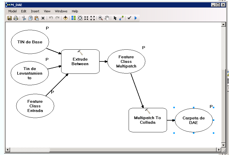

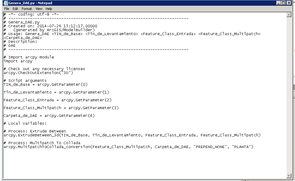

Hello, am trying to publish a geoprocesig service from a model that creates .DAE files . the problem is when i publish the tool, i cant modify the parameters, so i tried publishing a geoprocesing service from a python script that make the same task, but i fail again, the parameters are constants and i cant modify them.
i would like to know if  is possible to have a gp service with modificable inputs, for example, if i had a shapefile input, i would like to pass "c:/myfolder/myshape.shp" as parameter.
this is my model.
this is my script
any help!

It is certainly possible, although I am not sure if you can have intermediate output as a parameter of a geoprocessing service like the Multipatch Feature Class in your model. I guess it is important to make the distinction between input and output parameters.
I'd recommend adding Copy Features or Feature Class To Feature Class tool to copy the Multipatch Feature Class into say Multipatch Output, and making the Multipatch Output a Parameter instead of the Multipatch Feature Class (wchich will reside in some scratch workspace).
Similarly, you are missing arcpy.SetParameter in your python script to tell ArcGIS what to use as output from the script.

Thanks. when i run on desktop the gptool acepts dynamic, like this.
but, when is arcgis server, there are no option to set parameter via rest.
