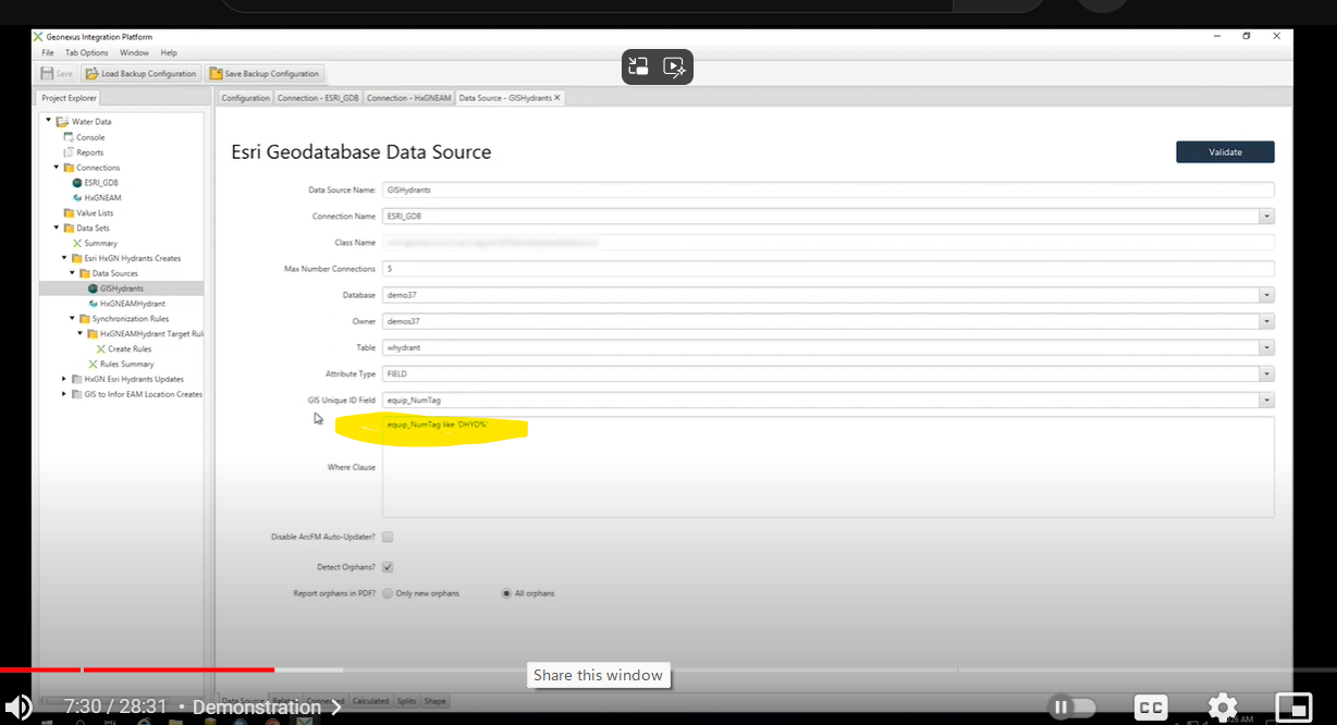

We are currently testing the integration between  Geonexus  and  EAMS (Enterprise Asset Management System)
We created a map service with a line feature class that has more that 90,000 records and digitized a new line.
When running the integration, it reads all records on the GIS side, and it compares them with all 90,000 records on  the EAMS side before it inserts the new record. In Geonexus in the Where Clause we hardcoded the new ID to select this specific record to be created in EAMS. Now we are looking for a way to dynamically pass a value in the  "Where Clause" file because there is a way to run a SQL Query to select all the records that are updated in the Delta tables in a traditional versioned database.
Anyone is currently doing that?
