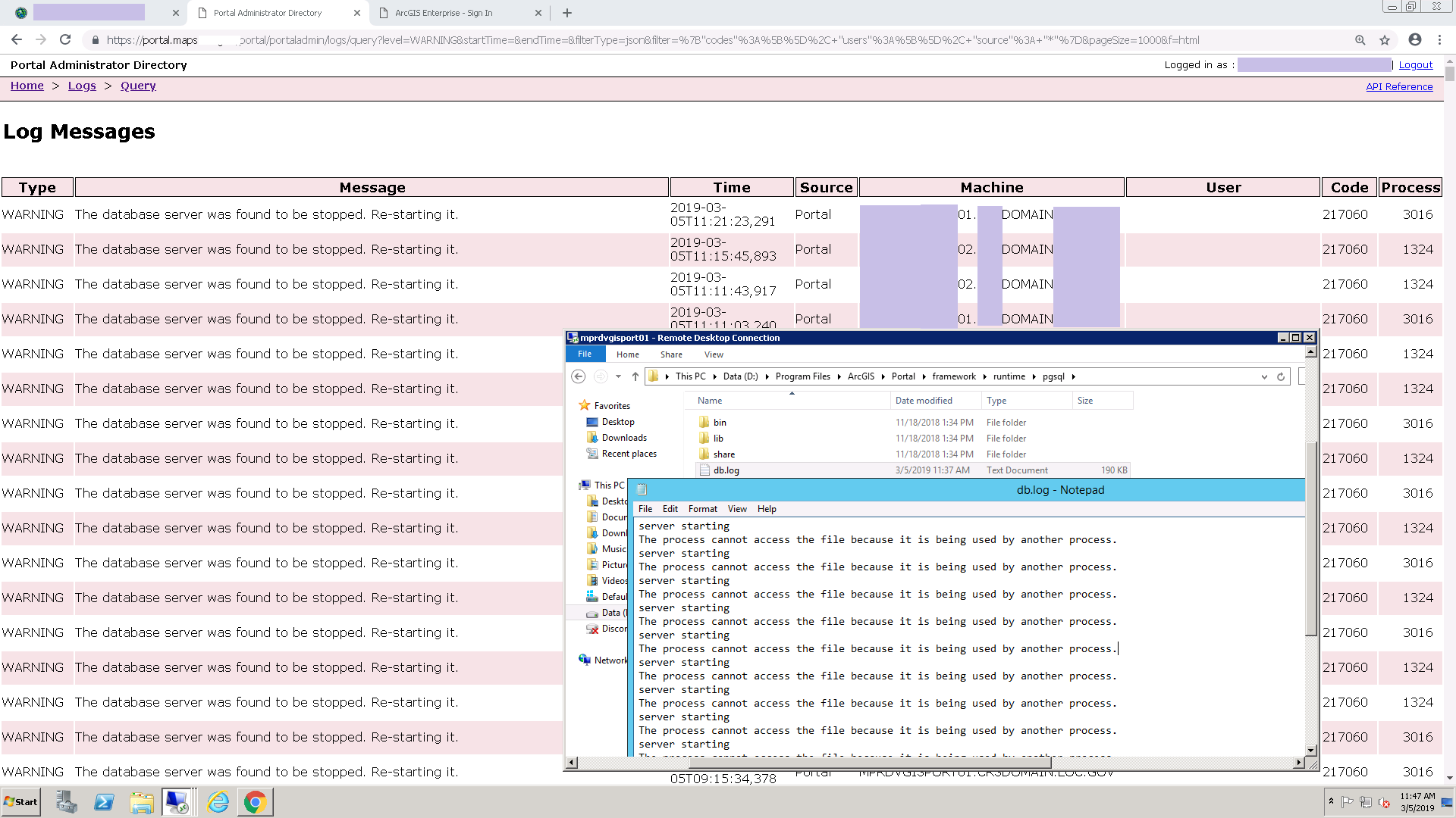

In our highly available ArcGIS Enterprise, we are seeing the error message below, logged every 5-10 minutes. As a result, we are seeing portal performance issues.
The database server was found to be stopped. Re-starting it.
When investigating the Portal DB framework logs, we found this error message logged at the same frequency:
The process cannot access the file because it is being used by another process
Our question is: what file is the database trying to access? Is there a resolution to this error.

If you stop the Portal service, do all Portal processes (ArcGISPortal.exe, javaw.exe, java.exe and postgresql.exe), go away? There may be an orphaned process that results in the errors in the db logs. We check to see whether the database is running, and since it can't start due to a potentially orphaned process, you'll see the errors logs in the Portal logs.

It looks like all Portal processes do go away--some javaw processes remain for the Server and Datastore elements.
We've also rebooted the server, and that solves the issue for a few days. Then it suddenly starts again, like some other process is triggering the problem.
Is is possible for Server or Datastore to be conflicting with the Portal processes?

Event viewer is showing this error message every time the log entry appears in Portaladmin:
The description for Event ID 0 from source PostgreSQL cannot be found. Either the component that raises this event is not installed on your local computer or the installation is corrupted. You can install or repair the component on the local computer.
If the event originated on another computer, the display information had to be saved with the event.
The following information was included with the event:
pg_ctl: another server might be running; trying to start server anyway
Would a reinstallation of portal resolve the issue? Or does it seem like the conflict is a different piece of software?

In our Portal there is also a frequent logging of this error, every 2, 3 or 4 hours during a day. We upgraded to 10.7, but these errors ocurred even when we were at 10.5.1 and 10.6. We have a dedicated machine for Portal, junst one machine, no HA, and at the time of these errors in the portal logs, in the event viewer two events are logged from PostgreSQL:
and after this one
pg_ctl: could not start server
Examine the log output.
PostgreSQL is running and listening on port 7654.
the db.log has the same lines as described by Michael.
So, overall, looks like the same behavior, regardless of HA, or other products installed on the same machine, data store listens on 9876.
