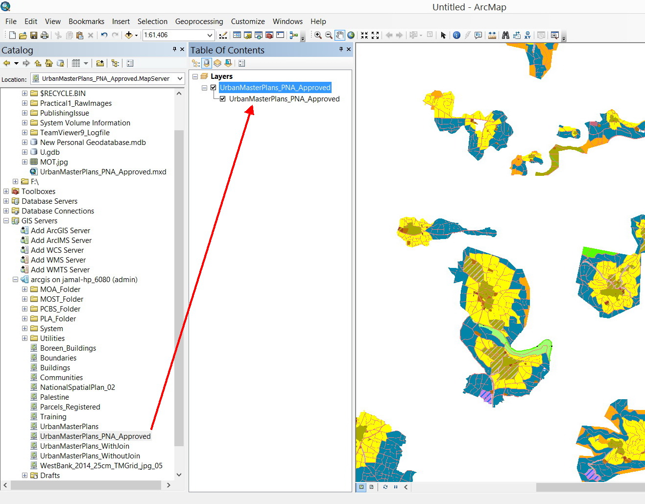

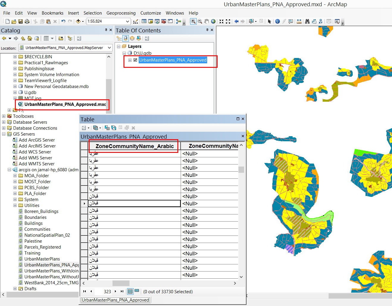

I have a layer that contains all Urban Master Plans (UMPs) for all municipalities across the country. This layer is published as a map service. Now, how can a municipality stick only its UMP in its web mapping application by filtering the map service according to a value in the “ZoneCommunityName” field?.

The destination of the map service of the UMPs is web mapping applications of municipalities. As all UMPs across the country are published in ONE map service (about 100,000 features), then Municipality A, for example, should be able to filter the entire service to obtain the UMP that corresponds to Municipality A only.
How filtering the UMPs service can affect only the one added to a particular mapping application? For example, I need to filter the UMPs service to obtain the UMP for municipality A and then other municipality should be able to filter the UMPs service to obtain the UMP for municipality B and so forth.
Is that possible?
