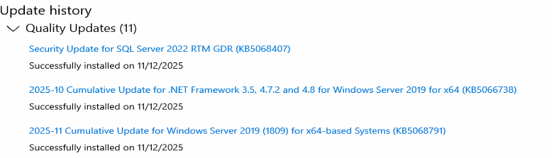

The machines worked perfectly last Wednesday.  No other changes were made except for the update patches to Windows.   I monitor a few more machines that are going to get the patches applied this next weekend and am hoping to find a root cause/solution before then.   I am attaching a screenshot of the updates that were applied, machines restarts and AGE is broken.

The server itself was restored to Pre-windows update phase and everything validated and worked perfectly fine.   Unfortunately, due to IP conflicting issues, we have had back to the post Windows Update phase. Now Datastore is broken/not validating and federation gives an error.  Luckily this is sufficient to get the GIS team working on stuff, but we are back to the original problem.  This is surely something from the windows update that is messing with the GIS elements.     We suspect:  https://support.microsoft.com/en-us/topic/november-11-2025-kb5068791-os-build-17763-8027-485c3175-0d...  is the problem child.
