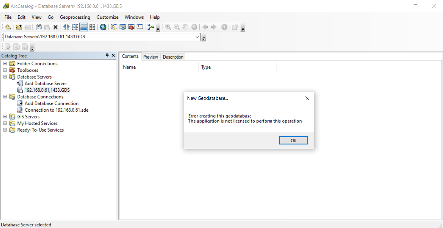

Hi all,
I have problem when trying to create a gdb from ArcCatalog 10.7.1. Below is the SS of the error.
FYI, I can create the gdb from the server itself by using ArcCatalog that I've installed in the server itself, but when I tried to create it through LAN network, got this error.
Server Version : ArcGIS Server WorkGroup Adv 10.7.1
DB : Database Server Workgroup (SQL Express 2014 SP3)
ArcGIS Client : ArcGIS Desktop Standard
TIA
by Anonymous User
Not applicable
Hello,
I've seen this once before and it was resolved by upgrading the SQL Server Express version to 2017. Is that possible?
Best,
-Lauren
