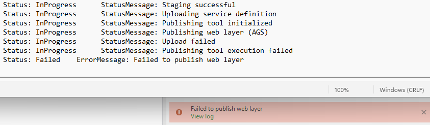

I try ArcGIS server and portal federated 11.0 with ArcGIS Pro 3.0 to evaluate changes for an old project.
When I try to publish a new mapservice from ArcGIS Pro, I have this error :
If
On debug log I have this error :

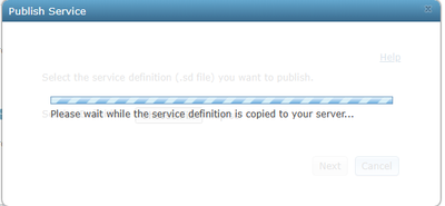

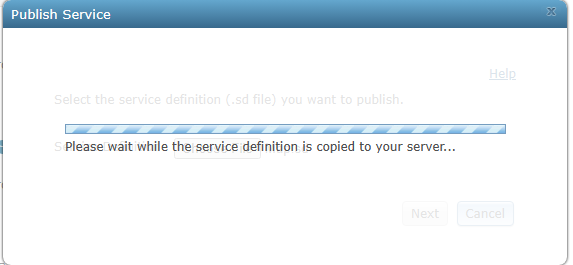

When I try to publish service directly on manager on webadaptor address :
I wait for an infinite time without result after click next :
When I try to publish service directly on manager on 6443 port : it's work !

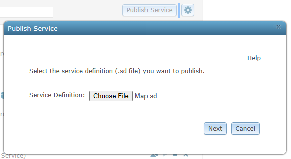

Creating an SD file in ArcGIS PRO was always possible.
When publishing the SD file via ArcGIS Server Manager, we expected strange behavior as the UI displayed the service information entry dialog blank, skipping the SD selection dialog.
When we pressed the back button, we were able to select the SD file and proceed with publishing, resulting in another notification that the System/PublishingTools would not run, even though we had just restarted them.
After another restart of the System/PublishingTools service, everything worked as expected again and we can now publish any service from ArcGIS PRO again.
