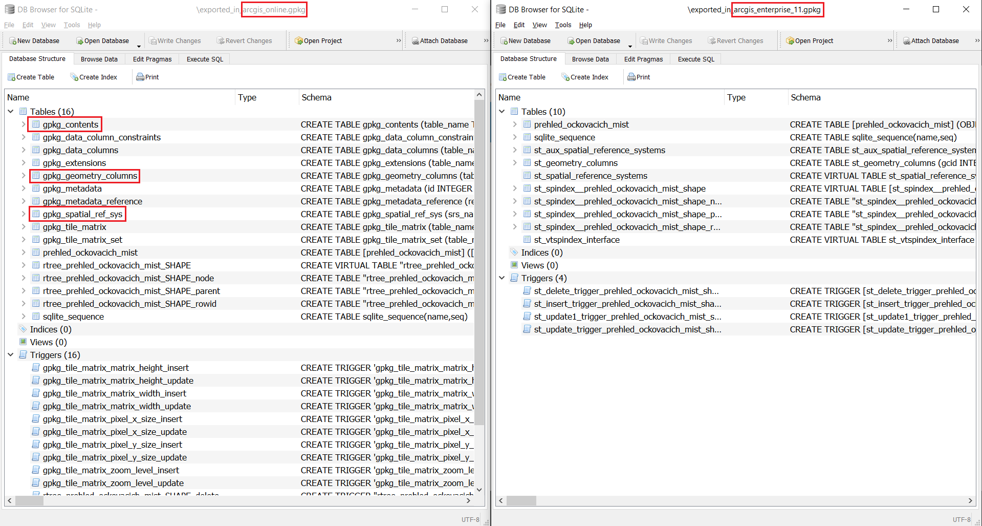

Hi,
A GeoPackage file exported from a hosted feature layer in ArcGIS Enterprise 11 is missing a required system tables: gpkg_spatial_ref_sys, gpkg_contents, gpkg_geometry_columns, which leads to the exported geopackage cannot be opened in a 3rd party applications.
A GeoPackage exported from a hosted feature layer in ArcGIS Online does contain the required system tables (see the attached screenshot) and can be used in other systems.
I'm also attaching the exported geopackage files.
