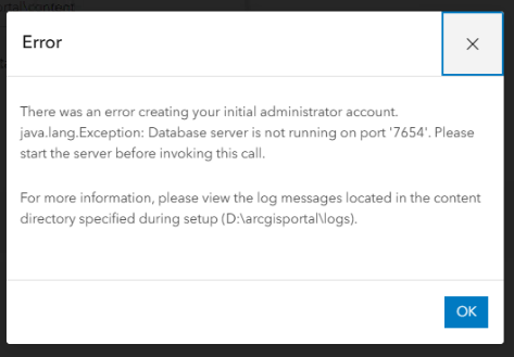

This is the error during creation of a new site
Observing "D:\arcgisportal" folder, "db" folder is created and then deleted when error appears.
"arcgis" user is local and has full control.

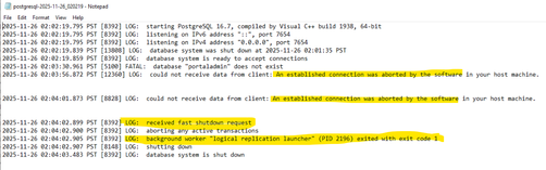

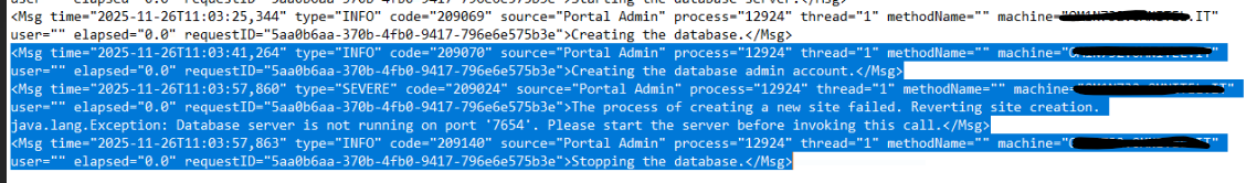

This is Portal Log

This is the third installation I've done from scratch, deleting the installation directory and the "arcgisportal" directory.
Thanks!!!
