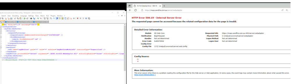

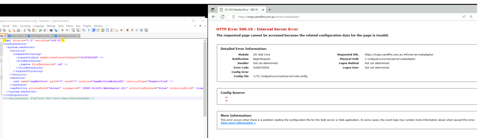

I am struggling to get the webadaptor for ArcGIS Enterprise 11.1 working. Please see  the error below. Please note the following
  • Tested 11.0 and it works however 11.1 failed with the error shown below.
  • Fresh install, win server 2022
  • I attempted to use 11.0 web.config with 11.1 and doesn’t work either.
  • I noted they look every different between 11.0 and 11.1

There are new prerequisites at 11.1 that must be applied.  Not needed at 11.0 or before.
https://enterprise.arcgis.com/en/system-requirements/latest/windowsarcgis-web-adaptor-system- requir....
Have you applied these?  I can confirm I've upgraded two clients from 10.9.1 to 11.1 this week and no issues with Web Adaptors - though they were using Server 2019.

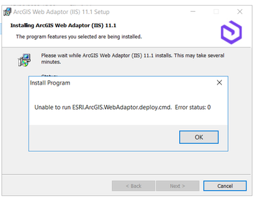

Hi Scott. Which version of the hosting bundle did you use for your successful upgrades? I am using 6.0.18 hosting bundle found here - Download .NET 6.0 (Linux, macOS, and Windows) (microsoft.com).
The link in on the esri documentation to .net 6.0 does not work.
I can't get  the web adaptor 11.1 to install as i get this error -
I think it has to do with the dot net 6 version not being picked up by the installer?
thanks

good to know that 6.0.18 is available.  I was using 6.0.16.  Have you installed webdeploy as well?  I used v 3.6

Hi Scott. Thanks for the reply. I did have web deployed installed also. Turns out the issue was actually with McAfee blocking one of the web adaptor processes due to it having a ‘suspicious double file extension’ for anyone else having this issue you can view the error in event viewer.
Scott_Tansley
MVP Regular Contributor
Possibly my least favourite AV, and yes, that'll do it.  Glad you sorted it.

Thank you so much for that. I had the .net 6 installed and NOT the hosting bundle. Thanks Scott.
