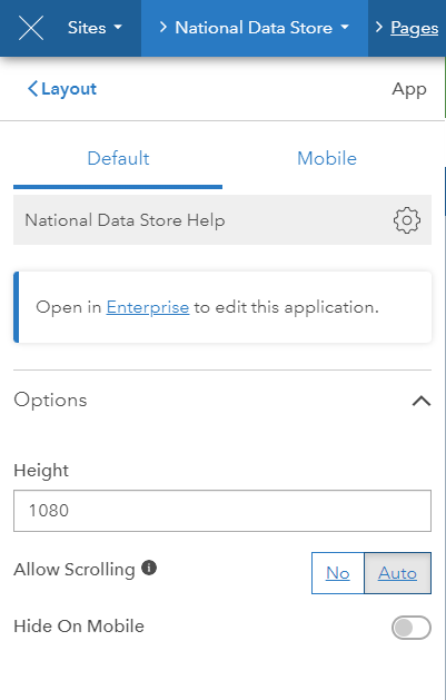

When this storymap is added to the Application Card on the Site, it is no longer responsive to screen sizes.  Either users on laptops can't see the full height of the images, or users with large monitors see a large blank area at the bottom of the page on the Site.
The only setting I can see to configure the height of the Application Card on the site is in "Options > Height" and this expects a fixed px value.
I have also tried adding the storymap to a page on the Site with an Iframe Card rather than an Application Card.  This also appears to have the same limitation with a fixed height value in px.
Is there a way to make the Application Card or Iframe Card on the Site responsive to screen size?  Setting a px value means it will only ever realistically work for a single screen size.
